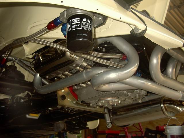

June 5, 2013 at 11:14 pm #256165I can’t even figure out where the valve cover is on this thing yet. LOL Any advice with valve adjustment? Also trying to figure out if my engine has been converted to a full flow filter and, if so, where the filter would be located. I have already done some research about the draining of oil and replacement of factory filters.

June 6, 2013 at 4:34 am #256167The VW oil pump resides behind the large crankshaft pulley on the center of the engine, down at the bottom. Should it have been converted to a full-flow filter, there’s about a 95 percent chance that you’ll find either a filter just to the left of that oil pump (where the cooling air exits the left side of the engine) or you’ll find oil lines from there running to a remote filter bolted somewhere else. This is the easiest way to convert one to a full-flow filter.Here’s a pic of a VW oil pump for a full-flow filter, remotely mounted under the left fender. ‘
And here’s a pic of an oil pump that the filter would screw directly onto. The filter screws onto the left side, and would be sticking out into that cooling air flow I mentioned, behind the pushrod tubes on the left side of the engine, visible only from below:
Early FF TDr on 69 VW pan
