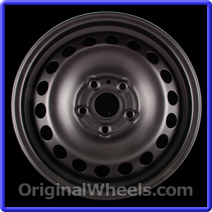

August 16, 2011 at 10:04 am #245558VW Rabbit stock wheels are 15 inch and have round holes. Just don’t know the setback on those.Also will have to pay attention to the spacing of the lugs or lug holes. May or may not fit the beetle 5-bolt wheel. BUT…this could be an option.

"If one thing matters, everything matters" - from the book The ShackAugust 16, 2011 at 10:53 am #245559Unfortunately, Rabbit Wheels won’t work.
Rabbit five bolt wheel:
http://www.originalwheels.com/volkswagen-wheels/images/volks wagen-rabbit-wheels-69893-b.jpg

August 16, 2011 at 11:20 am #245560Crapola!
Or should I say “Shazbot”!newkitman40771.5746412037Allen Caron
