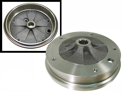

"If one thing matters, everything matters" - from the book The ShackJuly 28, 2011 at 2:48 pm #245500Stay away from re-drilled rotors and drums. The VW 4 bolt disc and drum has a “cross” pattern cast into the drum/rotor on the back side that makes the drum/rotor more than twice as thick where the log bolt holes are drilled and threaded.
If you buy redrilled drums/rotors, the threads are MUCH TOO THIN to safely secure the wheel because the lug holes are not redrilled through that thicker “cross” area on the backside of the drum.

July 28, 2011 at 3:22 pm #245501A picture is worth a thousand words. And in this case, really drives home Mark’s point about the bolt holes:
http://www.jbugs.com/store/graphics/00000001/VW-FRONT-BRAKE- DRUM-GERMAN-111405615B.jpg
The five bolt VW pattern is probably unique too. In case you need to know, it’s 205mm. The five bolt drum is also reinforced where the bolt holes are:
http://www.jbugs.com/store/graphics/00000001/VW-BUG-GHIA-FRO NT-BRAKE-DRUM-113501615A.jpg

July 28, 2011 at 3:35 pm #245503Thanks for posting those pics to illustrate what I tried to explain.
