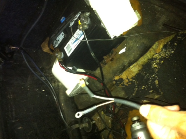

Finally getting to look under the hood and here is what I am seeing: I found this wire (under the spare tire, in front of vehicle), which was not connected to anything. It is taped up, comes from the area near the instrument panel and it has two wires coming out of it ( a gray and a brown one). I am thinking either the mechanic knocked them loose or they were connected somewhere or not connnected at all:

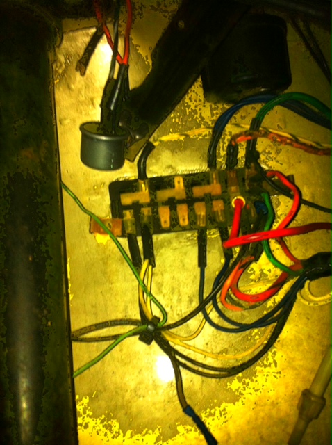

I am also including a photo of the wiring panel. Does it look OK to you guys? I am also including a photo of the wiring panel. Does it look OK to you guys?

March 30, 2011 at 1:53 pm #243995Gang,
So would anyone know where thse wires go? It is one brown and one grey.

March 30, 2011 at 9:53 pm #243996Leave them alone for now. Tape them up. Fix all the grounds first. THEN see if there’s something that still doesn’t work.
Trying to find a “use” or purpose for all the loose wires on a zillion-year-old car that someone else adapted wiring to is a fool’s errand.

April 13, 2011 at 1:44 am #244001Having fully rebuilt a Lafer I can tell you that on my car the gray and brown
wires in the front hood area go to the Fuel level sender installed on the gas
tank.
April 18, 2011 at 3:45 pm #244002thanks much :O) I had the floors redone a few years back and as I was leaving the shop, I had noticed the fuel was on empty, which was impossible, since I always have at least 1/2 a tank. The guy did not bother to test any wires. He just ran a new wire to the tank. That fixed it. Should I leave these alone? or connect them to the tank? Thanks for your help!
April 18, 2011 at 4:13 pm #244003wait…your fuel gauge works fine now…and you still want to mess with these wires?
If you want to play with them and the tank sender and fuel gauge, here is your illustrated primer.
Learn it. Live it. Love it.
But seriously, why not just tape them up and forget them or, better still, track them to their source and pull them out? Coil them up somewhere and store them in the shop. Or even in the car for an emergency.
